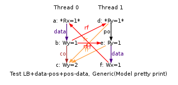

It is worth noticing that a given set of final values for all observed locations may cover more than one execution. For instance consider LB+data-pos+pos-data, a variation of of LB:
PPC LB+data-pos+pos-data
0:r2=x; 0:r4=y;
1:r2=y; 1:r5=x;
 P0           | P1           ;
 lwz r1,0(r2) | lwz r1,0(r2) ;
 xor r3,r1,r1 | lwz r3,0(r2) ;
 addi r3,r3,1 | xor r4,r3,r3 ;
 stw r3,0(r4) | addi r4,r4,1 ;
 li r5,2      | stw r4,0(r5) ;
 stw r5,0(r4) |              ;
exists
(y=2 /\ 0:r1=1 /\ 1:r1=1)
By observing the final values of registers 0:r1 and 1:r1, the above final condition targets some LB style non-SC execution abdf, or more precisely:

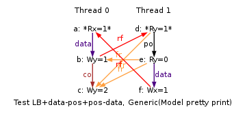

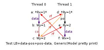

But the register 1:r3 (second load of y by Thread 1) has to get its value either from the initial value 0 of y, or from the stores to y by Thread 0 (b or c). This results in the following three executions:
Executions for behaviour: "0:r1=1 ; 1:r1=1 ; y=2"
Notice that, in the above LB+data-pos+pos-data example, the ambiguity in executions results from not observing the register 1:r3. Unfortunately many of our tests present such a lack of observation. To reveal that situation in execution diagram, we picture observed reads between two stars ’*’. For instance, in the above diagrams the first memory load by Thread 1 is written “d:*Ry=1* ”, while the second memory load is written “e:Ry=0”,“e:Ry=1”, and “e:Ry=2”.
