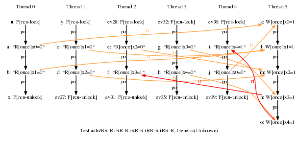

LISA auto/RR-R+RR-R+RR-R+RR-R+RR-R
* Result: Sometimes
* Process 0 starts (t=594996).
* P0 goes back a bit less than one grace period (t=495996).
* P1 goes back a bit less than one grace period (t=396997).
* P2 goes back a bit less than one grace period (t=297998).
* P3 goes back a bit less than one grace period (t=198999).
* P4 goes back a bit less than one grace period (t=100000).
* Process 0 start at t=594996, process 5 end at t=100000: Cycle allowed.
P0 | P1 | P2 | P3 | P4 | P5 ;
f[rcu_read_lock] | f[rcu_read_lock] | f[rcu_read_lock] | f[rcu_read_lock] | f[rcu_read_lock] | w[once] x0 1 ;
r[once] r1 x0 | r[once] r1 x1 | r[once] r1 x2 | r[once] r1 x3 | r[once] r1 x4 | w[once] x1 1 ;
r[once] r2 x1 | r[once] r2 x2 | r[once] r2 x3 | r[once] r2 x4 | r[once] r2 x0 | w[once] x2 1 ;
f[rcu_read_unlock] | f[rcu_read_unlock] | f[rcu_read_unlock] | f[rcu_read_unlock] | f[rcu_read_unlock] | w[once] x3 1 ;
| | | | | w[once] x4 1 ;
