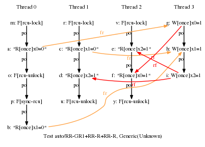

LISA auto/RR-GR1+RR-R+RR-R
* Result: Sometimes
* Process 0 starts (t=197998).
* P0 advances one grace period (t=297998).
* P1 goes back a bit less than one grace period (t=198999).
* P2 goes back a bit less than one grace period (t=100000).
* Process 0 start at t=197998, process 3 end at t=100000: Cycle allowed.
P0 | P1 | P2 | P3 ;
f[rcu_read_lock] | f[rcu_read_lock] | f[rcu_read_lock] | w[once] x0 1 ;
r[once] r1 x0 | r[once] r1 x1 | r[once] r1 x2 | w[once] x1 1 ;
f[rcu_read_unlock] | r[once] r2 x2 | r[once] r2 x0 | w[once] x2 1 ;
f[sync] | f[rcu_read_unlock] | f[rcu_read_unlock] | ;
r[once] r2 x1 | | | ;
Observed
2:r2=0; 2:r1=0; 1:r2=0; 1:r1=0; 0:r2=0; 0:r1=1;
and 2:r2=0; 2:r1=1; 1:r2=1; 1:r1=1; 0:r2=0; 0:r1=0;
and 2:r2=1; 2:r1=1; 1:r2=0; 1:r1=1; 0:r2=0; 0:r1=0;
and 2:r2=0; 2:r1=1; 1:r2=0; 1:r1=1; 0:r2=0; 0:r1=0;
and 2:r2=1; 2:r1=0; 1:r2=0; 1:r1=1; 0:r2=0; 0:r1=0;
and 2:r2=1; 2:r1=1; 1:r2=1; 1:r1=0; 0:r2=0; 0:r1=0;
and 2:r2=0; 2:r1=1; 1:r2=1; 1:r1=0; 0:r2=0; 0:r1=0;
and 2:r2=1; 2:r1=0; 1:r2=1; 1:r1=0; 0:r2=0; 0:r1=0;
