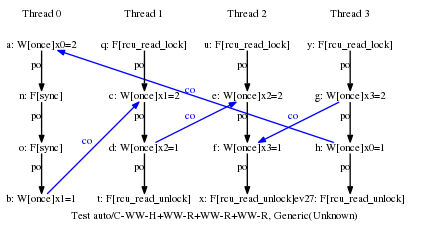

C auto/C-WW-H+WW-R+WW-R+WW-R
* Result: Sometimes
* Process 0 starts (t=196997).
* P0 advances two grace periods (t=396997).
* P1 goes back a bit less than one grace period (t=297998).
* P2 goes back a bit less than one grace period (t=198999).
* P3 goes back a bit less than one grace period (t=100000).
* Process 0 start at t=196997, process 4 end at t=100000: Cycle allowed.
P0(int *x0, int *x1)
WRITE_ONCE(*x0, 2);
synchronize_rcu();
synchronize_rcu();
WRITE_ONCE(*x1, 1);
P1(int *x1, int *x2)
rcu_read_lock();
WRITE_ONCE(*x1, 2);
WRITE_ONCE(*x2, 1);
rcu_read_unlock();
P2(int *x2, int *x3)
rcu_read_lock();
WRITE_ONCE(*x2, 2);
WRITE_ONCE(*x3, 1);
rcu_read_unlock();
P3(int *x0, int *x3)
rcu_read_lock();
WRITE_ONCE(*x3, 2);
WRITE_ONCE(*x0, 1);
rcu_read_unlock();
Observed
x3=1; x2=2; x1=2; x0=2;
and x3=2; x2=2; x1=2; x0=1;
and x3=1; x2=1; x1=2; x0=1;
