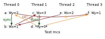

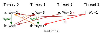

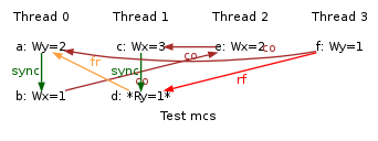

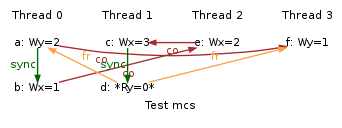

Test mcs
PPC mcs (PPCMTwelveSync)
x=0 ; y=0;
0:r4=x ; 0:r5=y;
1:r4=x ; 1:r5=y;
2:r4=x ; 2:r2=2 ;
3:r5=y ; 3:r1=1 ;
0:r1=1 ; 0:r2=2 ; 1:r3=3;
P0           |     P1       | P2           | P3          ;
stw r2,0(r5) | stw r3,0(r4) | stw r2,0(r4) |stw r1,0(r5) ;
sync         | sync         |              |             ;
stw r1,0(r4) | lwz r2,0(r5) |              |             ;
locations [1:r2; x; y;]
exists (1:r2=0 /\ x=3 /\ y=1 \/ 1:r2=0 /\ x=3 /\ y=2 \/ 1:r2=1 /\ x=3 /\ y=2)
