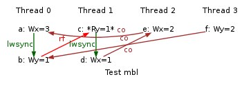

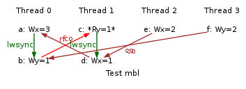

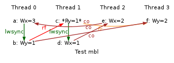

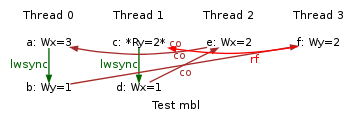

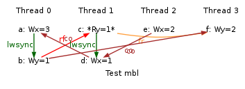

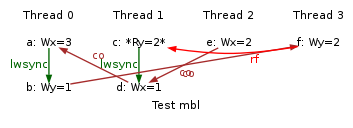

Test mbl
PPC mbl (PPCMElevenLwsync )
x=0 ; y=0;
0:r4=x ; 0:r5=y;
1:r4=x ; 1:r5=y;
2:r4=x ; 2:r2=2 ;
3:r5=y ; 3:r2=2 ;
0:r1=1 ; 0:r3=3 ; 1:r1=1;
P0           |     P1       | P2           | P3          ;
stw r3,0(r4) | lwz r2,0(r5) | stw r2,0(r4) |stw r2,0(r5) ;
lwsync       | lwsync       |              |             ;
stw r1,0(r5) | stw r1,0(r4) |              |             ;
locations [1:r2; x; y;]
exists (1:r2=1 /\ x=3 /\ y=1 \/ 1:r2=1 /\ x=3 /\ y=2 \/ 1:r2=2 /\ x=3 /\ y=2)
