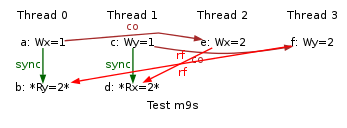

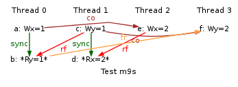

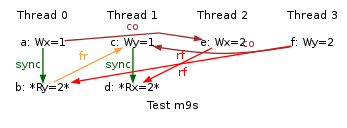

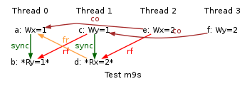

Test m9s
PPC m9s  (PPCMNineSync)
"ST ; LD || ST ; LD, hexa version (c tests in @xx)"
P0:r4=x ; P0:r5=y ; P0:r1=1 ;
P1:r4=x ; P1:r5=y ; P1:r1=1 ;
P2:r4=x ; P3:r5=y ;
P2:r2=2 ; P3:r2=2 ;
P0           |P1           |P2           |P3           ;
stw r1,0(r4) |stw r1,0(r5) |             |             ;
sync         |sync         |             |             ;
lwz r2,0(r5) |lwz r2,0(r4) |stw r2,0(r4) |stw r2,0(r5) ;
locations [0:r2; 1:r2; x; y;]
exists (true)
