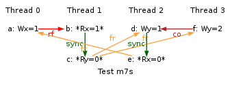

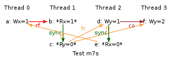

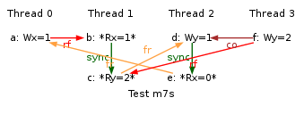

Test m7s
PPC m7s (PPCMSevenSync)
"hexa version of rwc, with syncs"
0:r5=x;
1:r5=x; 1:r6=y;
2:r5=x; 2:r6=y;
0:r1=1;
2:r1=1;
3:r2=2; 3:r6=y;
P0          |P1          |P2          |P3          ;
stw r1,0(r5)|lwz r1,0(r5)|stw r1,0(r6)|stw r2,0(r6);
            |sync        |sync        |            ;
            |lwz r2,0(r6)|lwz r3,0(r5)|            ;
locations [x; y;]
exists (1:r1=1 /\ 1:r2=0 /\ 2:r3=0 \/ 1:r1=1 /\ 1:r2=2 /\ 2:r3=0 /\ x=1 /\ y=1)
