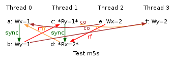

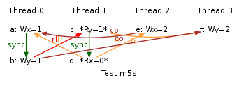

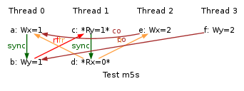

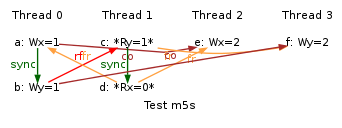

Test m5s
PPC m5s (PPCMFiveSync)
"Hexa test: ST ; ST || LD ; LD"
 0:r1=1; 0:r4=x; 0:r5=y; 1:r4=x; 1:r5=y;
 2:r2=2; 2:r4=x;
 3:r2=2; 3:r5=y;
P0           |P1           |P2           |P3           ;
stw r1,0(r4) |lwz r1,0(r5) |stw r2,0(r4) |stw r2,0(r5) ;
sync         |sync         |             |             ;
stw r1,0(r5) |lwz r2,0(r4) |             |             ;
locations [1:r1; 1:r2; x; y;]
exists (1:r1=1 /\ 1:r2=0 /\ x=1 /\ y=1 \/ 1:r1=1 /\ 1:r2=0 /\ x=1 /\ y=2 \/ 1:r1=1 /\ 1:r2=0 /\ x=2 /\ y=1 \/ 1:r1=1 /\ 1:r2=0 /\ x=2 /\ y=2 \/ 1:r1=1 /\ 1:r2=2 /\ x=1 /\ y=1 \/ 1:r1=1 /\ 1:r2=2 /\ x=1 /\ y=2)
