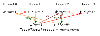

Test WRW+WR+reader+lwsync+sync
PPC WRW+WR+reader+lwsync+sync
"Rfe LwSyncdRW Wse SyncdWR Fre"
Cycle=Rfe LwSyncdRW Wse SyncdWR Fre
0:r2=x;
1:r2=x; 1:r4=y;
2:r2=y; 2:r4=x;
3:r2=y;
 P0           | P1           | P2           | P3           ;
 li r1,1      | lwz r1,0(r2) | li r1,2      | lwz r1,0(r2) ;
 stw r1,0(r2) | lwsync       | stw r1,0(r2) |              ;
              | li r3,1      | sync         |              ;
              | stw r3,0(r4) | lwz r3,0(r4) |              ;
exists
(y=2 /\ 1:r1=1 /\ 2:r3=0 /\ 3:r1=1)
Strange, forbidden in some experiment, while
simpler, apriori equivalent WRW+WR+lwsync+sync is allowed
