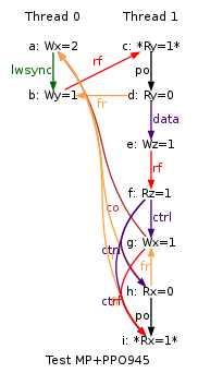

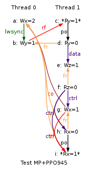

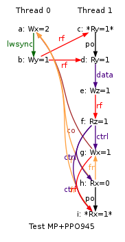

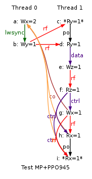

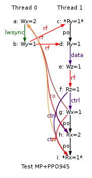

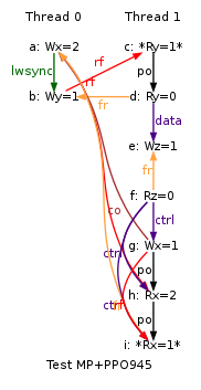

Test MP+PPO945
PPC MP+PPO945
"Fre LwSyncdWW Rfe PosRR DpDatadW PosWR DpCtrldW PosWR PosRR"
Cycle=Rfe PosRR DpDatadW PosWR DpCtrldW PosWR PosRR Fre LwSyncdWW
Relax=
Safe=Rfe Fre PosWR PosRR LwSyncdWW DpDatadW DpCtrldW
Prefetch=1:x=T
Com=Rf Fr
Orig=Fre LwSyncdWW Rfe PosRR DpDatadW PosWR DpCtrldW PosWR PosRR
0:r2=x; 0:r4=y;
1:r2=y; 1:r5=z; 1:r8=x;
 P0           | P1            ;
 li r1,2      | lwz r1,0(r2)  ;
 stw r1,0(r2) | lwz r3,0(r2)  ;
 lwsync       | xor r4,r3,r3  ;
 li r3,1      | addi r4,r4,1  ;
 stw r3,0(r4) | stw r4,0(r5)  ;
              | lwz r6,0(r5)  ;
              | cmpw r6,r6    ;
              | beq  LC00     ;
              | LC00:         ;
              | li r7,1       ;
              | stw r7,0(r8)  ;
              | lwz r9,0(r8)  ;
              | lwz r10,0(r8) ;
exists
(x=2 /\ 1:r1=1 /\ 1:r10=1)
