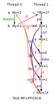

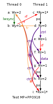

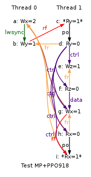

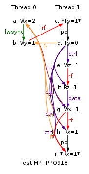

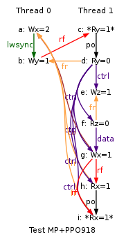

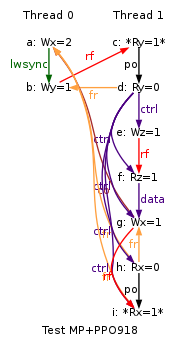

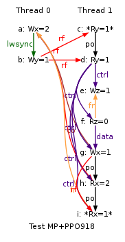

Test MP+PPO918
PPC MP+PPO918
"Fre LwSyncdWW Rfe PosRR DpCtrldW PosWR DpDatadW PosWR PosRR"
Cycle=Rfe PosRR DpCtrldW PosWR DpDatadW PosWR PosRR Fre LwSyncdWW
Relax=
Safe=Rfe Fre PosWR PosRR LwSyncdWW DpDatadW DpCtrldW
Prefetch=1:x=T
Com=Rf Fr
Orig=Fre LwSyncdWW Rfe PosRR DpCtrldW PosWR DpDatadW PosWR PosRR
0:r2=x; 0:r4=y;
1:r2=y; 1:r5=z; 1:r8=x;
 P0           | P1            ;
 li r1,2      | lwz r1,0(r2)  ;
 stw r1,0(r2) | lwz r3,0(r2)  ;
 lwsync       | cmpw r3,r3    ;
 li r3,1      | beq  LC00     ;
 stw r3,0(r4) | LC00:         ;
              | li r4,1       ;
              | stw r4,0(r5)  ;
              | lwz r6,0(r5)  ;
              | xor r7,r6,r6  ;
              | addi r7,r7,1  ;
              | stw r7,0(r8)  ;
              | lwz r9,0(r8)  ;
              | lwz r10,0(r8) ;
exists
(x=2 /\ 1:r1=1 /\ 1:r10=1)
