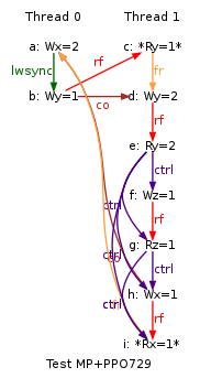

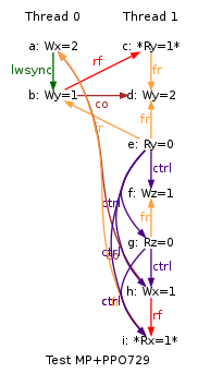

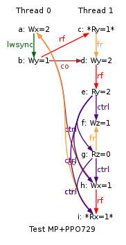

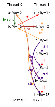

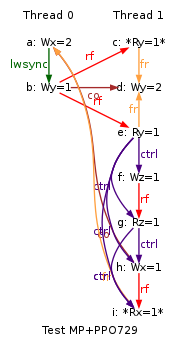

Test MP+PPO729
PPC MP+PPO729
"Fre LwSyncdWW Rfe PosRW PosWR DpCtrldW PosWR DpCtrldW PosWR"
Cycle=Rfe PosRW PosWR DpCtrldW PosWR DpCtrldW PosWR Fre LwSyncdWW
Relax=
Safe=Rfe Fre PosWR PosRW LwSyncdWW DpCtrldW
Prefetch=1:x=T
Com=Rf Fr
Orig=Fre LwSyncdWW Rfe PosRW PosWR DpCtrldW PosWR DpCtrldW PosWR
0:r2=x; 0:r4=y;
1:r2=y; 1:r6=z; 1:r9=x;
 P0           | P1            ;
 li r1,2      | lwz r1,0(r2)  ;
 stw r1,0(r2) | li r3,2       ;
 lwsync       | stw r3,0(r2)  ;
 li r3,1      | lwz r4,0(r2)  ;
 stw r3,0(r4) | cmpw r4,r4    ;
              | beq  LC00     ;
              | LC00:         ;
              | li r5,1       ;
              | stw r5,0(r6)  ;
              | lwz r7,0(r6)  ;
              | cmpw r7,r7    ;
              | beq  LC01     ;
              | LC01:         ;
              | li r8,1       ;
              | stw r8,0(r9)  ;
              | lwz r10,0(r9) ;
exists
(x=2 /\ y=2 /\ 1:r1=1 /\ 1:r10=1)
