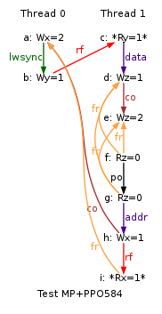

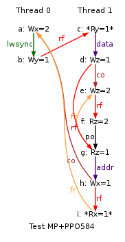

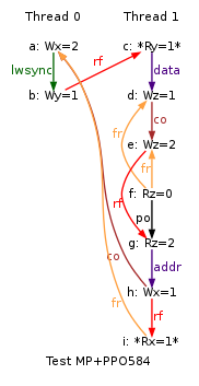

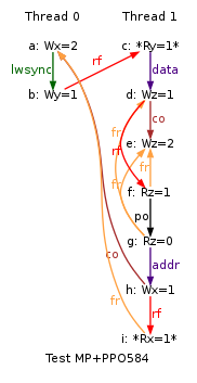

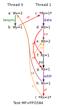

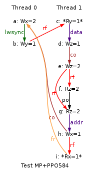

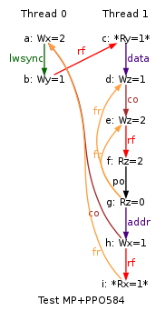

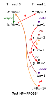

Test MP+PPO584
PPC MP+PPO584
"Fre LwSyncdWW Rfe DpDatadW PosWW PosWR PosRR DpAddrdW PosWR"
Cycle=Rfe DpDatadW PosWW PosWR PosRR DpAddrdW PosWR Fre LwSyncdWW
Relax=
Safe=Rfe Fre PosWW PosWR PosRR LwSyncdWW DpAddrdW DpDatadW
Prefetch=1:x=T
Com=Rf Fr
Orig=Fre LwSyncdWW Rfe DpDatadW PosWW PosWR PosRR DpAddrdW PosWR
0:r2=x; 0:r4=y;
1:r2=y; 1:r4=z; 1:r10=x;
 P0           | P1             ;
 li r1,2      | lwz r1,0(r2)   ;
 stw r1,0(r2) | xor r3,r1,r1   ;
 lwsync       | addi r3,r3,1   ;
 li r3,1      | stw r3,0(r4)   ;
 stw r3,0(r4) | li r5,2        ;
              | stw r5,0(r4)   ;
              | lwz r6,0(r4)   ;
              | lwz r7,0(r4)   ;
              | xor r8,r7,r7   ;
              | li r9,1        ;
              | stwx r9,r8,r10 ;
              | lwz r11,0(r10) ;
exists
(x=2 /\ z=2 /\ 1:r1=1 /\ 1:r11=1)
