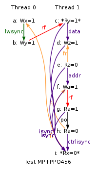

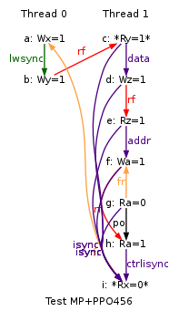

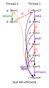

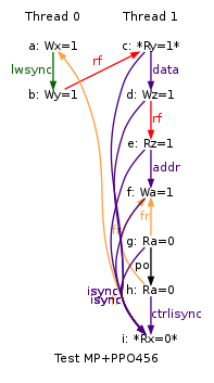

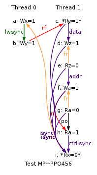

Test MP+PPO456
PPC MP+PPO456
"Fre LwSyncdWW Rfe DpDatadW PosWR DpAddrdW PosWR PosRR DpCtrlIsyncdR"
Cycle=Rfe DpDatadW PosWR DpAddrdW PosWR PosRR DpCtrlIsyncdR Fre LwSyncdWW
Relax=
Safe=Rfe Fre PosWR PosRR LwSyncdWW DpAddrdW DpDatadW DpCtrlIsyncdR
Prefetch=1:x=T
Com=Rf Fr
Orig=Fre LwSyncdWW Rfe DpDatadW PosWR DpAddrdW PosWR PosRR DpCtrlIsyncdR
0:r2=x; 0:r4=y;
1:r2=y; 1:r4=z; 1:r8=a; 1:r12=x;
 P0           | P1             ;
 li r1,1      | lwz r1,0(r2)   ;
 stw r1,0(r2) | xor r3,r1,r1   ;
 lwsync       | addi r3,r3,1   ;
 li r3,1      | stw r3,0(r4)   ;
 stw r3,0(r4) | lwz r5,0(r4)   ;
              | xor r6,r5,r5   ;
              | li r7,1        ;
              | stwx r7,r6,r8  ;
              | lwz r9,0(r8)   ;
              | lwz r10,0(r8)  ;
              | cmpw r10,r10   ;
              | beq  LC00      ;
              | LC00:          ;
              | isync          ;
              | lwz r11,0(r12) ;
exists
(1:r1=1 /\ 1:r11=0)
