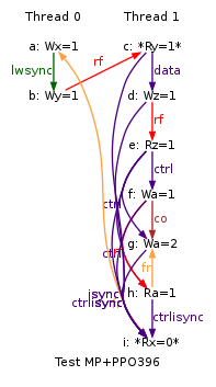

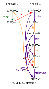

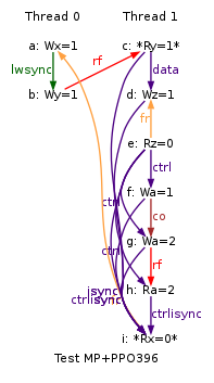

Test MP+PPO396
PPC MP+PPO396
"Fre LwSyncdWW Rfe DpDatadW PosWR DpCtrldW PosWW PosWR DpCtrlIsyncdR"
Cycle=Rfe DpDatadW PosWR DpCtrldW PosWW PosWR DpCtrlIsyncdR Fre LwSyncdWW
Relax=
Safe=Rfe Fre PosWW PosWR LwSyncdWW DpDatadW DpCtrldW DpCtrlIsyncdR
Prefetch=1:x=T
Com=Rf Fr
Orig=Fre LwSyncdWW Rfe DpDatadW PosWR DpCtrldW PosWW PosWR DpCtrlIsyncdR
0:r2=x; 0:r4=y;
1:r2=y; 1:r4=z; 1:r7=a; 1:r11=x;
 P0           | P1             ;
 li r1,1      | lwz r1,0(r2)   ;
 stw r1,0(r2) | xor r3,r1,r1   ;
 lwsync       | addi r3,r3,1   ;
 li r3,1      | stw r3,0(r4)   ;
 stw r3,0(r4) | lwz r5,0(r4)   ;
              | cmpw r5,r5     ;
              | beq  LC00      ;
              | LC00:          ;
              | li r6,1        ;
              | stw r6,0(r7)   ;
              | li r8,2        ;
              | stw r8,0(r7)   ;
              | lwz r9,0(r7)   ;
              | cmpw r9,r9     ;
              | beq  LC01      ;
              | LC01:          ;
              | isync          ;
              | lwz r10,0(r11) ;
exists
(a=2 /\ 1:r1=1 /\ 1:r10=0)
