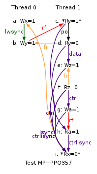

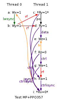

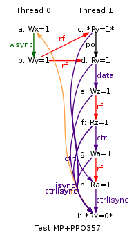

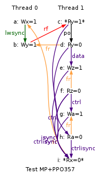

Test MP+PPO357
PPC MP+PPO357
"Fre LwSyncdWW Rfe PosRR DpDatadW PosWR DpCtrldW PosWR DpCtrlIsyncdR"
Cycle=Rfe PosRR DpDatadW PosWR DpCtrldW PosWR DpCtrlIsyncdR Fre LwSyncdWW
Relax=
Safe=Rfe Fre PosWR PosRR LwSyncdWW DpDatadW DpCtrldW DpCtrlIsyncdR
Prefetch=1:x=T
Com=Rf Fr
Orig=Fre LwSyncdWW Rfe PosRR DpDatadW PosWR DpCtrldW PosWR DpCtrlIsyncdR
0:r2=x; 0:r4=y;
1:r2=y; 1:r5=z; 1:r8=a; 1:r11=x;
 P0           | P1             ;
 li r1,1      | lwz r1,0(r2)   ;
 stw r1,0(r2) | lwz r3,0(r2)   ;
 lwsync       | xor r4,r3,r3   ;
 li r3,1      | addi r4,r4,1   ;
 stw r3,0(r4) | stw r4,0(r5)   ;
              | lwz r6,0(r5)   ;
              | cmpw r6,r6     ;
              | beq  LC00      ;
              | LC00:          ;
              | li r7,1        ;
              | stw r7,0(r8)   ;
              | lwz r9,0(r8)   ;
              | cmpw r9,r9     ;
              | beq  LC01      ;
              | LC01:          ;
              | isync          ;
              | lwz r10,0(r11) ;
exists
(1:r1=1 /\ 1:r10=0)
