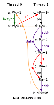

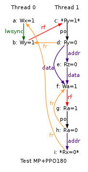

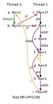

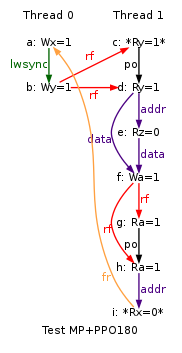

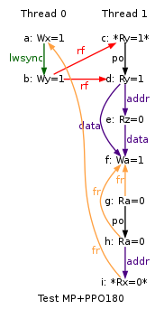

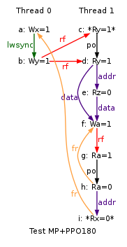

Test MP+PPO180
PPC MP+PPO180
"Fre LwSyncdWW Rfe PosRR DpAddrdR DpDatadW PosWR PosRR DpAddrdR"
Cycle=Rfe PosRR DpAddrdR DpDatadW PosWR PosRR DpAddrdR Fre LwSyncdWW
Relax=
Safe=Rfe Fre PosWR PosRR LwSyncdWW DpAddrdR DpDatadW
Prefetch=1:x=T
Com=Rf Fr
Orig=Fre LwSyncdWW Rfe PosRR DpAddrdR DpDatadW PosWR PosRR DpAddrdR
0:r2=x; 0:r4=y;
1:r2=y; 1:r6=z; 1:r8=a; 1:r13=x;
 P0           | P1               ;
 li r1,1      | lwz r1,0(r2)     ;
 stw r1,0(r2) | lwz r3,0(r2)     ;
 lwsync       | xor r4,r3,r3     ;
 li r3,1      | lwzx r5,r4,r6    ;
 stw r3,0(r4) | xor r7,r5,r5     ;
              | addi r7,r7,1     ;
              | stw r7,0(r8)     ;
              | lwz r9,0(r8)     ;
              | lwz r10,0(r8)    ;
              | xor r11,r10,r10  ;
              | lwzx r12,r11,r13 ;
exists
(1:r1=1 /\ 1:r12=0)
