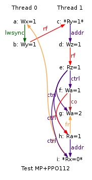

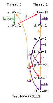

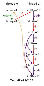

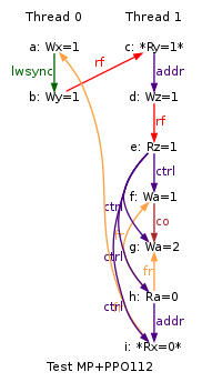

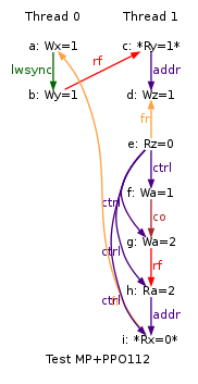

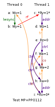

Test MP+PPO112
PPC MP+PPO112
"Fre LwSyncdWW Rfe DpAddrdW PosWR DpCtrldW PosWW PosWR DpAddrdR"
Cycle=Rfe DpAddrdW PosWR DpCtrldW PosWW PosWR DpAddrdR Fre LwSyncdWW
Relax=
Safe=Rfe Fre PosWW PosWR LwSyncdWW DpAddrdW DpAddrdR DpCtrldW
Prefetch=1:x=T
Com=Rf Fr
Orig=Fre LwSyncdWW Rfe DpAddrdW PosWR DpCtrldW PosWW PosWR DpAddrdR
0:r2=x; 0:r4=y;
1:r2=y; 1:r5=z; 1:r8=a; 1:r13=x;
 P0           | P1               ;
 li r1,1      | lwz r1,0(r2)     ;
 stw r1,0(r2) | xor r3,r1,r1     ;
 lwsync       | li r4,1          ;
 li r3,1      | stwx r4,r3,r5    ;
 stw r3,0(r4) | lwz r6,0(r5)     ;
              | cmpw r6,r6       ;
              | beq  LC00        ;
              | LC00:            ;
              | li r7,1          ;
              | stw r7,0(r8)     ;
              | li r9,2          ;
              | stw r9,0(r8)     ;
              | lwz r10,0(r8)    ;
              | xor r11,r10,r10  ;
              | lwzx r12,r11,r13 ;
exists
(a=2 /\ 1:r1=1 /\ 1:r12=0)
