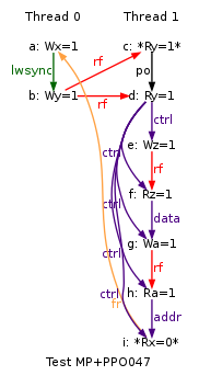

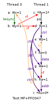

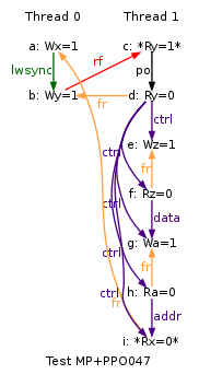

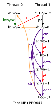

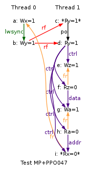

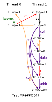

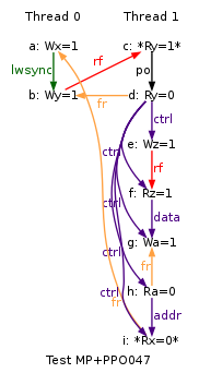

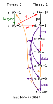

Test MP+PPO047
PPC MP+PPO047
"Fre LwSyncdWW Rfe PosRR DpCtrldW PosWR DpDatadW PosWR DpAddrdR"
Cycle=Rfe PosRR DpCtrldW PosWR DpDatadW PosWR DpAddrdR Fre LwSyncdWW
Relax=
Safe=Rfe Fre PosWR PosRR LwSyncdWW DpAddrdR DpDatadW DpCtrldW
Prefetch=1:x=T
Com=Rf Fr
Orig=Fre LwSyncdWW Rfe PosRR DpCtrldW PosWR DpDatadW PosWR DpAddrdR
0:r2=x; 0:r4=y;
1:r2=y; 1:r5=z; 1:r8=a; 1:r12=x;
 P0           | P1               ;
 li r1,1      | lwz r1,0(r2)     ;
 stw r1,0(r2) | lwz r3,0(r2)     ;
 lwsync       | cmpw r3,r3       ;
 li r3,1      | beq  LC00        ;
 stw r3,0(r4) | LC00:            ;
              | li r4,1          ;
              | stw r4,0(r5)     ;
              | lwz r6,0(r5)     ;
              | xor r7,r6,r6     ;
              | addi r7,r7,1     ;
              | stw r7,0(r8)     ;
              | lwz r9,0(r8)     ;
              | xor r10,r9,r9    ;
              | lwzx r11,r10,r12 ;
exists
(1:r1=1 /\ 1:r11=0)
