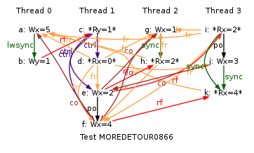

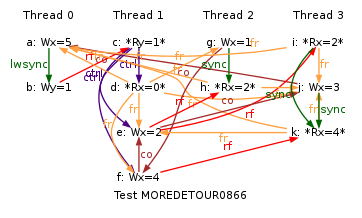

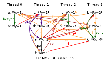

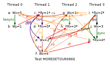

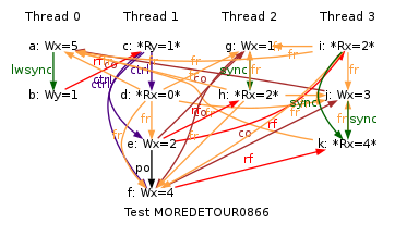

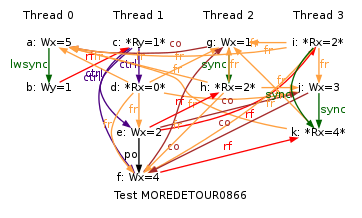

Test MOREDETOUR0866
PPC MOREDETOUR0866
"LwSyncdWW Rfe DpCtrldR DetourRW DetourWW Wse"
Cycle=Rfe DpCtrldR DetourRW DetourWW Wse LwSyncdWW
Prefetch=0:x=F,0:y=W,1:y=F,1:x=W
Com=Rf Ws
Orig=LwSyncdWW Rfe DpCtrldR DetourRW DetourWW Wse
0:r2=x; 0:r4=y;
1:r2=y; 1:r4=x;
2:r2=x;
3:r2=x;
 P0           | P1           | P2           | P3           ;
 li r1,5      | lwz r1,0(r2) | li r1,1      | lwz r1,0(r2) ;
 stw r1,0(r2) | cmpw r1,r1   | stw r1,0(r2) | li r3,3      ;
 lwsync       | beq  LC00    | sync         | stw r3,0(r2) ;
 li r3,1      | LC00:        | lwz r3,0(r2) | sync         ;
 stw r3,0(r4) | lwz r3,0(r4) |              | lwz r4,0(r2) ;
              | li r5,2      |              |              ;
              | stw r5,0(r4) |              |              ;
              | li r6,4      |              |              ;
              | stw r6,0(r4) |              |              ;
exists
(x=5 /\ 1:r1=1 /\ 1:r3=0 /\ 2:r3=2 /\ 3:r4=4 /\ 3:r1=2)
