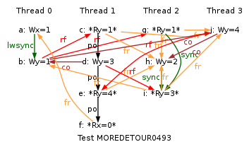

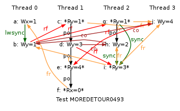

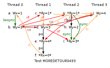

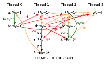

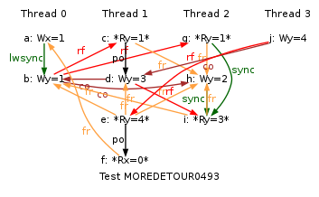

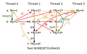

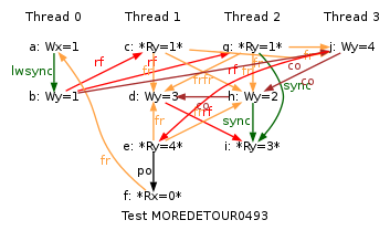

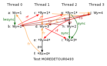

Test MOREDETOUR0493
PPC MOREDETOUR0493
"LwSyncdWW Rfe DetourRW DetourW PodRR Fre"
Cycle=Rfe DetourRW DetourW PodRR Fre LwSyncdWW
Prefetch=0:x=F,0:y=W,1:y=F,1:x=T
Com=Rf Fr
Orig=LwSyncdWW Rfe DetourRW DetourW PodRR Fre
0:r2=x; 0:r4=y;
1:r2=y; 1:r6=x;
2:r2=y;
3:r2=y;
 P0           | P1           | P2           | P3           ;
 li r1,1      | lwz r1,0(r2) | lwz r1,0(r2) | li r1,4      ;
 stw r1,0(r2) | li r3,3      | li r3,2      | stw r1,0(r2) ;
 lwsync       | stw r3,0(r2) | stw r3,0(r2) |              ;
 li r3,1      | lwz r4,0(r2) | sync         |              ;
 stw r3,0(r4) | lwz r5,0(r6) | lwz r4,0(r2) |              ;
exists
(1:r1=1 /\ 1:r4=4 /\ 1:r5=0 /\ 2:r4=3 /\ 2:r1=1)
