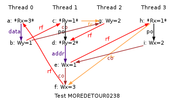

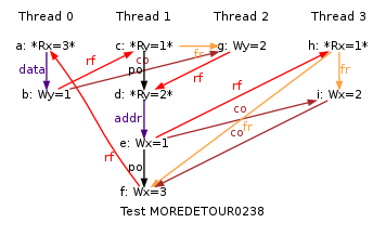

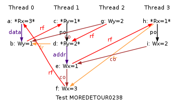

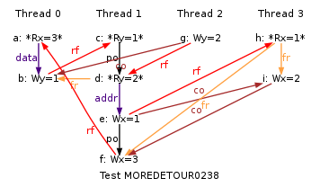

Test MOREDETOUR0238
PPC MOREDETOUR0238
"DpDatadW Rfe DetourR DpAddrdW DetourWW Rfe"
Cycle=Rfe DetourR DpAddrdW DetourWW Rfe DpDatadW
Prefetch=0:x=F,0:y=W,1:y=F,1:x=W
Com=Rf Rf
Orig=DpDatadW Rfe DetourR DpAddrdW DetourWW Rfe
0:r2=x; 0:r4=y;
1:r2=y; 1:r6=x;
2:r2=y;
3:r2=x;
 P0           | P1            | P2           | P3           ;
 lwz r1,0(r2) | lwz r1,0(r2)  | li r1,2      | lwz r1,0(r2) ;
 xor r3,r1,r1 | lwz r3,0(r2)  | stw r1,0(r2) | li r3,2      ;
 addi r3,r3,1 | xor r4,r3,r3  |              | stw r3,0(r2) ;
 stw r3,0(r4) | li r5,1       |              |              ;
              | stwx r5,r4,r6 |              |              ;
              | li r7,3       |              |              ;
              | stw r7,0(r6)  |              |              ;
exists
(0:r1=3 /\ 1:r1=1 /\ 1:r3=2 /\ x=3 /\ 3:r1=1)
