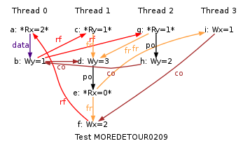

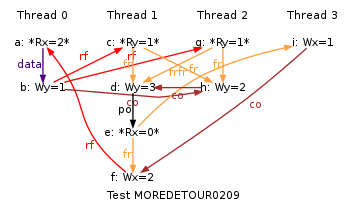

Test MOREDETOUR0209
PPC MOREDETOUR0209
"DpDatadW Rfe DetourRW PodWR DetourRW Rfe"
Cycle=Rfe DetourRW PodWR DetourRW Rfe DpDatadW
Prefetch=0:x=F,0:y=W,1:y=F,1:x=W
Com=Rf Rf
Orig=DpDatadW Rfe DetourRW PodWR DetourRW Rfe
0:r2=x; 0:r4=y;
1:r2=y; 1:r5=x;
2:r2=y;
3:r2=x;
 P0           | P1           | P2           | P3           ;
 lwz r1,0(r2) | lwz r1,0(r2) | lwz r1,0(r2) | li r1,1      ;
 xor r3,r1,r1 | li r3,3      | li r3,2      | stw r1,0(r2) ;
 addi r3,r3,1 | stw r3,0(r2) | stw r3,0(r2) |              ;
 stw r3,0(r4) | lwz r4,0(r5) |              |              ;
              | li r6,2      |              |              ;
              | stw r6,0(r5) |              |              ;
exists
(0:r1=2 /\ 1:r1=1 /\ 1:r4=0 /\ y=3 /\ 2:r1=1 /\ x=2)
