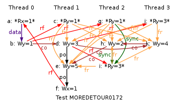

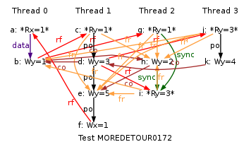

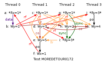

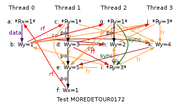

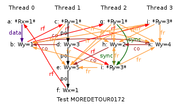

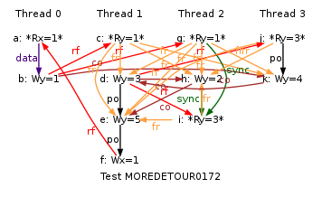

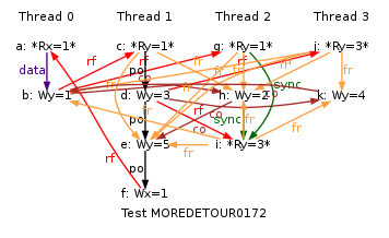

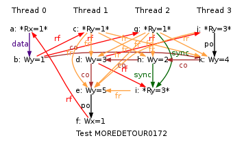

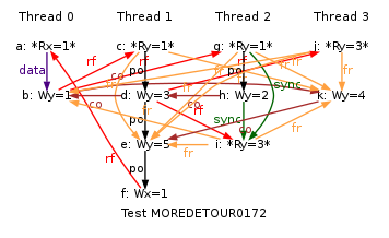

Test MOREDETOUR0172
PPC MOREDETOUR0172
"DpDatadW Rfe DetourRW DetourWW PodWW Rfe"
Cycle=Rfe DetourRW DetourWW PodWW Rfe DpDatadW
Prefetch=0:x=F,0:y=W,1:y=F,1:x=W
Com=Rf Rf
Orig=DpDatadW Rfe DetourRW DetourWW PodWW Rfe
0:r2=x; 0:r4=y;
1:r2=y; 1:r6=x;
2:r2=y;
3:r2=y;
 P0           | P1           | P2           | P3           ;
 lwz r1,0(r2) | lwz r1,0(r2) | lwz r1,0(r2) | lwz r1,0(r2) ;
 xor r3,r1,r1 | li r3,3      | li r3,2      | li r3,4      ;
 addi r3,r3,1 | stw r3,0(r2) | stw r3,0(r2) | stw r3,0(r2) ;
 stw r3,0(r4) | li r4,5      | sync         |              ;
              | stw r4,0(r2) | lwz r4,0(r2) |              ;
              | li r5,1      |              |              ;
              | stw r5,0(r6) |              |              ;
exists
(0:r1=1 /\ 1:r1=1 /\ 2:r4=3 /\ 2:r1=1 /\ y=5 /\ 3:r1=3)
