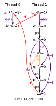

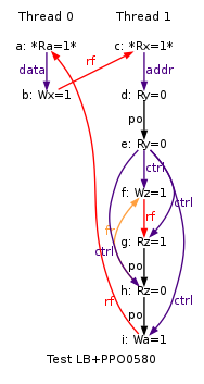

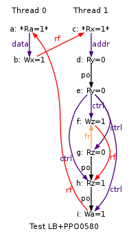

Test LB+PPO0580
PPC LB+PPO0580
"PodRW Rfe DpDatadW Rfe DpAddrdR PosRR DpCtrldW PosWR PosRR"
Cycle=Rfe DpAddrdR PosRR DpCtrldW PosWR PosRR PodRW Rfe DpDatadW
Relax=
Safe=Rfe PosWR PosRR Pod*W DpAddrdR DpDatadW DpCtrldW
Prefetch=
Com=Rf Rf
Orig=PodRW Rfe DpDatadW Rfe DpAddrdR PosRR DpCtrldW PosWR PosRR
0:r2=a; 0:r4=x;
1:r2=x; 1:r5=y; 1:r8=z; 1:r12=a;
 P0           | P1             ;
 lwz r1,0(r2) | lwz r1,0(r2)   ;
 xor r3,r1,r1 | xor r3,r1,r1   ;
 addi r3,r3,1 | lwzx r4,r3,r5  ;
 stw r3,0(r4) | lwz r6,0(r5)   ;
              | cmpw r6,r6     ;
              | beq  LC00      ;
              | LC00:          ;
              | li r7,1        ;
              | stw r7,0(r8)   ;
              | lwz r9,0(r8)   ;
              | lwz r10,0(r8)  ;
              | li r11,1       ;
              | stw r11,0(r12) ;
exists
(0:r1=1 /\ 1:r1=1)
