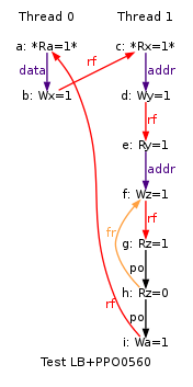

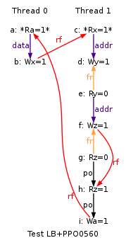

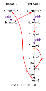

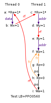

Test LB+PPO0560
PPC LB+PPO0560
"PodRW Rfe DpDatadW Rfe DpAddrdW PosWR DpAddrdW PosWR PosRR"
Cycle=Rfe DpAddrdW PosWR DpAddrdW PosWR PosRR PodRW Rfe DpDatadW
Relax=
Safe=Rfe PosWR PosRR Pod*W DpAddrdW DpDatadW
Prefetch=
Com=Rf Rf
Orig=PodRW Rfe DpDatadW Rfe DpAddrdW PosWR DpAddrdW PosWR PosRR
0:r2=a; 0:r4=x;
1:r2=x; 1:r5=y; 1:r9=z; 1:r13=a;
 P0           | P1             ;
 lwz r1,0(r2) | lwz r1,0(r2)   ;
 xor r3,r1,r1 | xor r3,r1,r1   ;
 addi r3,r3,1 | li r4,1        ;
 stw r3,0(r4) | stwx r4,r3,r5  ;
              | lwz r6,0(r5)   ;
              | xor r7,r6,r6   ;
              | li r8,1        ;
              | stwx r8,r7,r9  ;
              | lwz r10,0(r9)  ;
              | lwz r11,0(r9)  ;
              | li r12,1       ;
              | stw r12,0(r13) ;
exists
(0:r1=1 /\ 1:r1=1)
