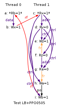

Test LB+PPO0505
PPC LB+PPO0505
"PodWW Rfe DpDatadW Rfe DpAddrdR DpCtrldW PosWR DpAddrdR PosRW"
Cycle=Rfe DpAddrdR DpCtrldW PosWR DpAddrdR PosRW PodWW Rfe DpDatadW
Relax=
Safe=Rfe PosWR PosRW Pod*W DpAddrdR DpDatadW DpCtrldW
Prefetch=
Com=Rf Rf
Orig=PodWW Rfe DpDatadW Rfe DpAddrdR DpCtrldW PosWR DpAddrdR PosRW
0:r2=b; 0:r4=x;
1:r2=x; 1:r5=y; 1:r7=z; 1:r11=a; 1:r14=b;
 P0           | P1              ;
 lwz r1,0(r2) | lwz r1,0(r2)    ;
 xor r3,r1,r1 | xor r3,r1,r1    ;
 addi r3,r3,1 | lwzx r4,r3,r5   ;
 stw r3,0(r4) | cmpw r4,r4      ;
              | beq  LC00       ;
              | LC00:           ;
              | li r6,1         ;
              | stw r6,0(r7)    ;
              | lwz r8,0(r7)    ;
              | xor r9,r8,r8    ;
              | lwzx r10,r9,r11 ;
              | li r12,1        ;
              | stw r12,0(r11)  ;
              | li r13,1        ;
              | stw r13,0(r14)  ;
exists
(0:r1=1 /\ 1:r1=1)
