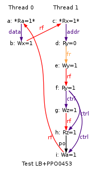

Test LB+PPO0453
PPC LB+PPO0453
"PodRW Rfe DpDatadW Rfe DpAddrdR PosRW PosWR DpCtrldW PosWR"
Cycle=Rfe DpAddrdR PosRW PosWR DpCtrldW PosWR PodRW Rfe DpDatadW
Relax=
Safe=Rfe PosWR PosRW Pod*W DpAddrdR DpDatadW DpCtrldW
Prefetch=
Com=Rf Rf
Orig=PodRW Rfe DpDatadW Rfe DpAddrdR PosRW PosWR DpCtrldW PosWR
0:r2=a; 0:r4=x;
1:r2=x; 1:r5=y; 1:r9=z; 1:r12=a;
 P0           | P1             ;
 lwz r1,0(r2) | lwz r1,0(r2)   ;
 xor r3,r1,r1 | xor r3,r1,r1   ;
 addi r3,r3,1 | lwzx r4,r3,r5  ;
 stw r3,0(r4) | li r6,1        ;
              | stw r6,0(r5)   ;
              | lwz r7,0(r5)   ;
              | cmpw r7,r7     ;
              | beq  LC00      ;
              | LC00:          ;
              | li r8,1        ;
              | stw r8,0(r9)   ;
              | lwz r10,0(r9)  ;
              | li r11,1       ;
              | stw r11,0(r12) ;
exists
(0:r1=1 /\ 1:r1=1)
