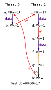

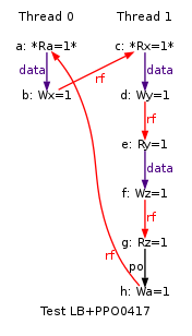

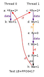

Test LB+PPO0417
PPC LB+PPO0417
"PodRW Rfe DpDatadW Rfe DpDatadW PosWR DpDatadW PosWR"
Cycle=Rfe DpDatadW Rfe DpDatadW PosWR DpDatadW PosWR PodRW
Relax=
Safe=Rfe PosWR Pod*W DpDatadW
Prefetch=
Com=Rf Rf
Orig=PodRW Rfe DpDatadW Rfe DpDatadW PosWR DpDatadW PosWR
0:r2=a; 0:r4=x;
1:r2=x; 1:r4=y; 1:r7=z; 1:r10=a;
 P0           | P1            ;
 lwz r1,0(r2) | lwz r1,0(r2)  ;
 xor r3,r1,r1 | xor r3,r1,r1  ;
 addi r3,r3,1 | addi r3,r3,1  ;
 stw r3,0(r4) | stw r3,0(r4)  ;
              | lwz r5,0(r4)  ;
              | xor r6,r5,r5  ;
              | addi r6,r6,1  ;
              | stw r6,0(r7)  ;
              | lwz r8,0(r7)  ;
              | li r9,1       ;
              | stw r9,0(r10) ;
exists
(0:r1=1 /\ 1:r1=1)
