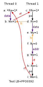

Test LB+PPO0392
PPC LB+PPO0392
"PodRW Rfe DpDatadW Rfe PosRR DpDatadW PosWR DpAddrdW PosWR"
Cycle=Rfe PosRR DpDatadW PosWR DpAddrdW PosWR PodRW Rfe DpDatadW
Relax=
Safe=Rfe PosWR PosRR Pod*W DpAddrdW DpDatadW
Prefetch=
Com=Rf Rf
Orig=PodRW Rfe DpDatadW Rfe PosRR DpDatadW PosWR DpAddrdW PosWR
0:r2=a; 0:r4=x;
1:r2=x; 1:r5=y; 1:r9=z; 1:r12=a;
 P0           | P1             ;
 lwz r1,0(r2) | lwz r1,0(r2)   ;
 xor r3,r1,r1 | lwz r3,0(r2)   ;
 addi r3,r3,1 | xor r4,r3,r3   ;
 stw r3,0(r4) | addi r4,r4,1   ;
              | stw r4,0(r5)   ;
              | lwz r6,0(r5)   ;
              | xor r7,r6,r6   ;
              | li r8,1        ;
              | stwx r8,r7,r9  ;
              | lwz r10,0(r9)  ;
              | li r11,1       ;
              | stw r11,0(r12) ;
exists
(0:r1=1 /\ 1:r1=1)
