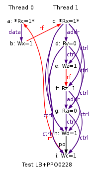

Test LB+PPO0228
PPC LB+PPO0228
"PodWW Rfe DpDatadW Rfe DpAddrdR DpCtrldW PosWR DpAddrdR DpCtrldW"
Cycle=Rfe DpAddrdR DpCtrldW PosWR DpAddrdR DpCtrldW PodWW Rfe DpDatadW
Relax=
Safe=Rfe PosWR Pod*W DpAddrdR DpDatadW DpCtrldW
Prefetch=
Com=Rf Rf
Orig=PodWW Rfe DpDatadW Rfe DpAddrdR DpCtrldW PosWR DpAddrdR DpCtrldW
0:r2=c; 0:r4=x;
1:r2=x; 1:r5=y; 1:r7=z; 1:r11=a; 1:r13=b; 1:r15=c;
 P0           | P1              ;
 lwz r1,0(r2) | lwz r1,0(r2)    ;
 xor r3,r1,r1 | xor r3,r1,r1    ;
 addi r3,r3,1 | lwzx r4,r3,r5   ;
 stw r3,0(r4) | cmpw r4,r4      ;
              | beq  LC00       ;
              | LC00:           ;
              | li r6,1         ;
              | stw r6,0(r7)    ;
              | lwz r8,0(r7)    ;
              | xor r9,r8,r8    ;
              | lwzx r10,r9,r11 ;
              | cmpw r10,r10    ;
              | beq  LC01       ;
              | LC01:           ;
              | li r12,1        ;
              | stw r12,0(r13)  ;
              | li r14,1        ;
              | stw r14,0(r15)  ;
exists
(0:r1=1 /\ 1:r1=1)
