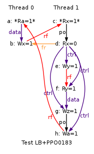

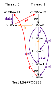

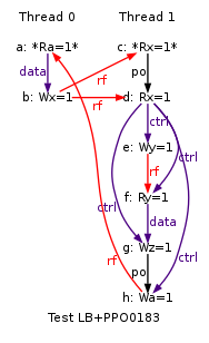

Test LB+PPO0183
PPC LB+PPO0183
"PodWW Rfe DpDatadW Rfe PosRR DpCtrldW PosWR DpDatadW"
Cycle=Rfe PosRR DpCtrldW PosWR DpDatadW PodWW Rfe DpDatadW
Relax=
Safe=Rfe PosWR PosRR Pod*W DpDatadW DpCtrldW
Prefetch=
Com=Rf Rf
Orig=PodWW Rfe DpDatadW Rfe PosRR DpCtrldW PosWR DpDatadW
0:r2=a; 0:r4=x;
1:r2=x; 1:r5=y; 1:r8=z; 1:r10=a;
 P0           | P1            ;
 lwz r1,0(r2) | lwz r1,0(r2)  ;
 xor r3,r1,r1 | lwz r3,0(r2)  ;
 addi r3,r3,1 | cmpw r3,r3    ;
 stw r3,0(r4) | beq  LC00     ;
              | LC00:         ;
              | li r4,1       ;
              | stw r4,0(r5)  ;
              | lwz r6,0(r5)  ;
              | xor r7,r6,r6  ;
              | addi r7,r7,1  ;
              | stw r7,0(r8)  ;
              | li r9,1       ;
              | stw r9,0(r10) ;
exists
(0:r1=1 /\ 1:r1=1)
