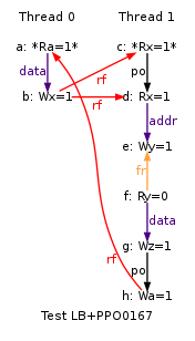

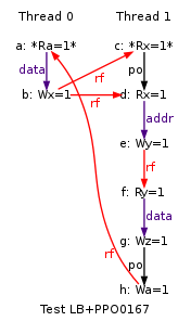

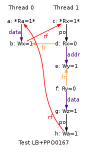

Test LB+PPO0167
PPC LB+PPO0167
"PodWW Rfe DpDatadW Rfe PosRR DpAddrdW PosWR DpDatadW"
Cycle=Rfe PosRR DpAddrdW PosWR DpDatadW PodWW Rfe DpDatadW
Relax=
Safe=Rfe PosWR PosRR Pod*W DpAddrdW DpDatadW
Prefetch=
Com=Rf Rf
Orig=PodWW Rfe DpDatadW Rfe PosRR DpAddrdW PosWR DpDatadW
0:r2=a; 0:r4=x;
1:r2=x; 1:r6=y; 1:r9=z; 1:r11=a;
 P0           | P1             ;
 lwz r1,0(r2) | lwz r1,0(r2)   ;
 xor r3,r1,r1 | lwz r3,0(r2)   ;
 addi r3,r3,1 | xor r4,r3,r3   ;
 stw r3,0(r4) | li r5,1        ;
              | stwx r5,r4,r6  ;
              | lwz r7,0(r6)   ;
              | xor r8,r7,r7   ;
              | addi r8,r8,1   ;
              | stw r8,0(r9)   ;
              | li r10,1       ;
              | stw r10,0(r11) ;
exists
(0:r1=1 /\ 1:r1=1)
