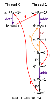

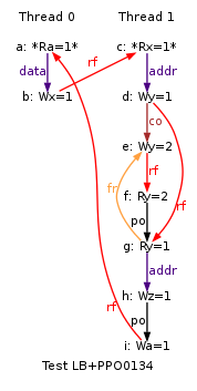

Test LB+PPO0134
PPC LB+PPO0134
"PodWW Rfe DpDatadW Rfe DpAddrdW PosWW PosWR PosRR DpAddrdW"
Cycle=Rfe DpAddrdW PosWW PosWR PosRR DpAddrdW PodWW Rfe DpDatadW
Relax=
Safe=Rfe PosWW PosWR PosRR Pod*W DpAddrdW DpDatadW
Prefetch=
Com=Rf Rf
Orig=PodWW Rfe DpDatadW Rfe DpAddrdW PosWW PosWR PosRR DpAddrdW
0:r2=a; 0:r4=x;
1:r2=x; 1:r5=y; 1:r11=z; 1:r13=a;
 P0           | P1              ;
 lwz r1,0(r2) | lwz r1,0(r2)    ;
 xor r3,r1,r1 | xor r3,r1,r1    ;
 addi r3,r3,1 | li r4,1         ;
 stw r3,0(r4) | stwx r4,r3,r5   ;
              | li r6,2         ;
              | stw r6,0(r5)    ;
              | lwz r7,0(r5)    ;
              | lwz r8,0(r5)    ;
              | xor r9,r8,r8    ;
              | li r10,1        ;
              | stwx r10,r9,r11 ;
              | li r12,1        ;
              | stw r12,0(r13)  ;
exists
(y=2 /\ 0:r1=1 /\ 1:r1=1)
