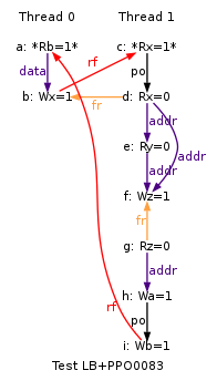

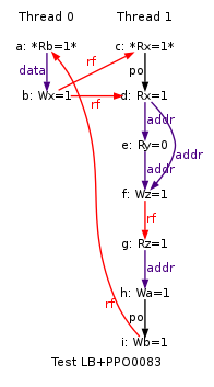

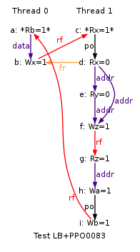

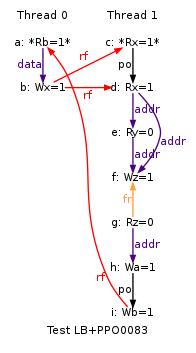

Test LB+PPO0083
PPC LB+PPO0083
"PodWW Rfe DpDatadW Rfe PosRR DpAddrdR DpAddrdW PosWR DpAddrdW"
Cycle=Rfe PosRR DpAddrdR DpAddrdW PosWR DpAddrdW PodWW Rfe DpDatadW
Relax=
Safe=Rfe PosWR PosRR Pod*W DpAddrdW DpAddrdR DpDatadW
Prefetch=
Com=Rf Rf
Orig=PodWW Rfe DpDatadW Rfe PosRR DpAddrdR DpAddrdW PosWR DpAddrdW
0:r2=b; 0:r4=x;
1:r2=x; 1:r6=y; 1:r9=z; 1:r13=a; 1:r15=b;
 P0           | P1               ;
 lwz r1,0(r2) | lwz r1,0(r2)     ;
 xor r3,r1,r1 | lwz r3,0(r2)     ;
 addi r3,r3,1 | xor r4,r3,r3     ;
 stw r3,0(r4) | lwzx r5,r4,r6    ;
              | xor r7,r5,r5     ;
              | li r8,1          ;
              | stwx r8,r7,r9    ;
              | lwz r10,0(r9)    ;
              | xor r11,r10,r10  ;
              | li r12,1         ;
              | stwx r12,r11,r13 ;
              | li r14,1         ;
              | stw r14,0(r15)   ;
exists
(0:r1=1 /\ 1:r1=1)
