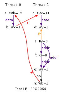

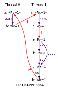

Test LB+PPO0064
PPC LB+PPO0064
"PodWW Rfe DpDatadW Rfe DpDatadW PosWR DpAddrdR DpAddrdW"
Cycle=Rfe DpDatadW Rfe DpDatadW PosWR DpAddrdR DpAddrdW PodWW
Relax=
Safe=Rfe PosWR Pod*W DpAddrdW DpAddrdR DpDatadW
Prefetch=
Com=Rf Rf
Orig=PodWW Rfe DpDatadW Rfe DpDatadW PosWR DpAddrdR DpAddrdW
0:r2=b; 0:r4=x;
1:r2=x; 1:r4=y; 1:r8=z; 1:r11=a; 1:r13=b;
 P0           | P1              ;
 lwz r1,0(r2) | lwz r1,0(r2)    ;
 xor r3,r1,r1 | xor r3,r1,r1    ;
 addi r3,r3,1 | addi r3,r3,1    ;
 stw r3,0(r4) | stw r3,0(r4)    ;
              | lwz r5,0(r4)    ;
              | xor r6,r5,r5    ;
              | lwzx r7,r6,r8   ;
              | xor r9,r7,r7    ;
              | li r10,1        ;
              | stwx r10,r9,r11 ;
              | li r12,1        ;
              | stw r12,0(r13)  ;
exists
(0:r1=1 /\ 1:r1=1)
