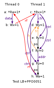

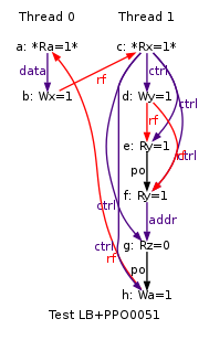

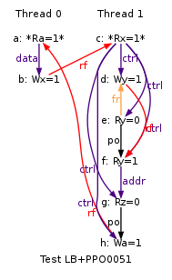

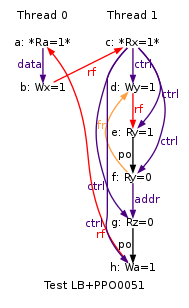

Test LB+PPO0051
PPC LB+PPO0051
"PodRW Rfe DpDatadW Rfe DpCtrldW PosWR PosRR DpAddrdR"
Cycle=Rfe DpDatadW Rfe DpCtrldW PosWR PosRR DpAddrdR PodRW
Relax=
Safe=Rfe PosWR PosRR Pod*W DpAddrdR DpDatadW DpCtrldW
Prefetch=
Com=Rf Rf
Orig=PodRW Rfe DpDatadW Rfe DpCtrldW PosWR PosRR DpAddrdR
0:r2=a; 0:r4=x;
1:r2=x; 1:r4=y; 1:r9=z; 1:r11=a;
 P0           | P1             ;
 lwz r1,0(r2) | lwz r1,0(r2)   ;
 xor r3,r1,r1 | cmpw r1,r1     ;
 addi r3,r3,1 | beq  LC00      ;
 stw r3,0(r4) | LC00:          ;
              | li r3,1        ;
              | stw r3,0(r4)   ;
              | lwz r5,0(r4)   ;
              | lwz r6,0(r4)   ;
              | xor r7,r6,r6   ;
              | lwzx r8,r7,r9  ;
              | li r10,1       ;
              | stw r10,0(r11) ;
exists
(0:r1=1 /\ 1:r1=1)
