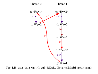

Test LB+data+data-wsi-rfi-ctrl+REAL
Executions for behaviour: "0:R0=1 ; 1:R0=2 ; 1:R3=3 ; x=1 ; y=2 ; z=3"
ARM LB+data+data-wsi-rfi-ctrl+REAL
"DpDatadW Rfe DpDatadW Wsi Rfi DpCtrldW Rfe"
Prefetch=0:x=F,0:y=W,1:y=F,1:x=W
Com=Rf Rf
Orig=DpDatadW Rfe DpDatadW Wsi Rfi DpCtrldW Rfe
%x0=x; %y0=y;
%y1=y; %z1=z; %x1=x;
