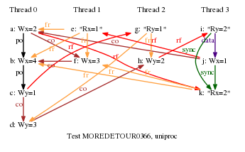

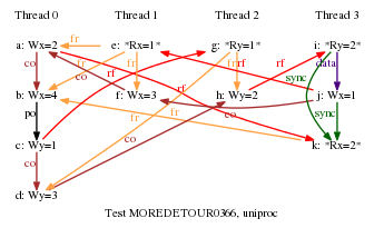

Test MOREDETOUR0366
PPC MOREDETOUR0366
"DetourWW PodWW DetourWW Rfe DpDatadW Wse"
Cycle=Rfe DpDatadW Wse DetourWW PodWW DetourWW
Prefetch=0:x=F,0:y=W,1:y=F,1:x=W
Com=Rf Ws
Orig=DetourWW PodWW DetourWW Rfe DpDatadW Wse
0:r2=x; 0:r5=y;
1:r2=x;
2:r2=y;
3:r2=y; 3:r4=x;
 P0           | P1           | P2           | P3           ;
 li r1,2      | lwz r1,0(r2) | lwz r1,0(r2) | lwz r1,0(r2) ;
 stw r1,0(r2) | li r3,3      | li r3,2      | xor r3,r1,r1 ;
 li r3,4      | stw r3,0(r2) | stw r3,0(r2) | addi r3,r3,1 ;
 stw r3,0(r2) |              |              | stw r3,0(r4) ;
 li r4,1      |              |              | sync         ;
 stw r4,0(r5) |              |              | lwz r5,0(r4) ;
 li r6,3      |              |              |              ;
 stw r6,0(r5) |              |              |              ;
Observed
    1:r1=1; 2:r1=1; 3:r1=2; 3:r5=2; x=4; y=2;
