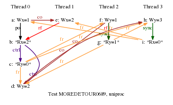

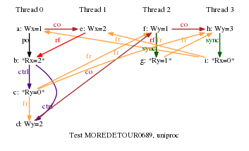

Test MOREDETOUR0689
PPC MOREDETOUR0689
"DetourW DpCtrldR DetourRW Wse SyncdWR Fre"
Cycle=Fre DetourW DpCtrldR DetourRW Wse SyncdWR
Prefetch=0:x=F,0:y=W,1:y=F,1:x=T
Com=Ws Fr
Orig=DetourW DpCtrldR DetourRW Wse SyncdWR Fre
0:r2=x; 0:r5=y;
1:r2=x;
2:r2=y;
3:r2=y; 3:r4=x;
 P0           | P1           | P2           | P3           ;
 li r1,1      | li r1,2      | li r1,1      | li r1,3      ;
 stw r1,0(r2) | stw r1,0(r2) | stw r1,0(r2) | stw r1,0(r2) ;
 lwz r3,0(r2) |              | sync         | sync         ;
 cmpw r3,r3   |              | lwz r3,0(r2) | lwz r3,0(r4) ;
 beq  LC00    |              |              |              ;
 LC00:        |              |              |              ;
 lwz r4,0(r5) |              |              |              ;
 li r6,2      |              |              |              ;
 stw r6,0(r5) |              |              |              ;
Observed
    0:r3=2; 0:r4=0; 2:r3=1; 3:r3=0; y=3;
