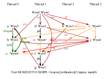

Test MOREDETOUR0899
Executions for behaviour: "0:r5=4 ; 1:r3=4 ; 3:r1=0 ; x=2 ; y=5"
PPC MOREDETOUR0899
"LwSyncdWW Wse DetourW DetourRW PodWW Wse"
Cycle=Wse DetourW DetourRW PodWW Wse LwSyncdWW
Prefetch=0:x=F,0:y=W,1:y=F,1:x=W
Com=Ws Ws
Orig=LwSyncdWW Wse DetourW DetourRW PodWW Wse
0:r2=x; 0:r4=y;
1:r2=y; 1:r6=x;
2:r2=y;
3:r2=y;
 P0           | P1           | P2           | P3           ;
 li r1,2      | li r1,2      | li r1,3      | lwz r1,0(r2) ;
 stw r1,0(r2) | stw r1,0(r2) | stw r1,0(r2) | li r3,4      ;
 lwsync       | lwz r3,0(r2) |              | stw r3,0(r2) ;
 li r3,1      | li r4,5      |              |              ;
 stw r3,0(r4) | stw r4,0(r2) |              |              ;
 sync         | li r5,1      |              |              ;
 lwz r5,0(r4) | stw r5,0(r6) |              |              ;
Observed
    0:r5=4; 1:r3=4; 3:r1=0; x=2; y=5;
