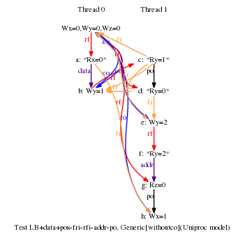

Executions for behaviour: "0:R0=0 ; 1:R0=1 ; 1:R1=0 ; 1:R3=2 ; y=2"

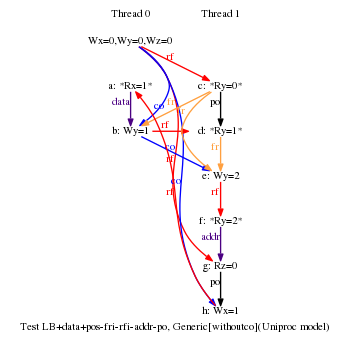

Executions for behaviour: "0:R0=1 ; 1:R0=0 ; 1:R1=1 ; 1:R3=2 ; y=2"

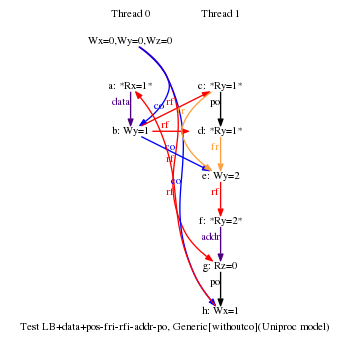

Executions for behaviour: "0:R0=1 ; 1:R0=1 ; 1:R1=1 ; 1:R3=2 ; y=2"

    0:R0=0; 1:R0=1; 1:R1=0; 1:R3=2; y=2;
and 0:R0=1; 1:R0=0; 1:R1=1; 1:R3=2; y=2;
and 0:R0=1; 1:R0=1; 1:R1=1; 1:R3=2; y=2;
