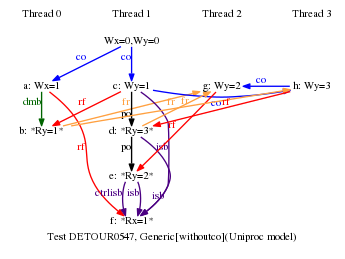

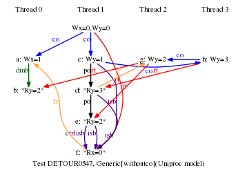

Test DETOUR0547
Executions for behaviour: "0:R1=2 ; 1:R1=3 ; 1:R2=2 ; 1:R3=0"
Executions for behaviour: "0:R1=3 ; 1:R1=2 ; 1:R2=3 ; 1:R3=0"
Executions for behaviour: "0:R1=1 ; 1:R1=3 ; 1:R2=2 ; 1:R3=1"
ARM DETOUR0547
"DMBdWR Fre DetourW DetourR DpCtrlIsbdR Fre"
Cycle=Fre DetourW DetourR DpCtrlIsbdR Fre DMBdWR
Prefetch=0:x=F,0:y=T,1:y=F,1:x=T
Com=Fr Fr
Orig=DMBdWR Fre DetourW DetourR DpCtrlIsbdR Fre
%x0=x; %y0=y;
%y1=y; %x1=x;
%y2=y;
%y3=y;
 P0           | P1           | P2           | P3           ;
 MOV R0,#1    | MOV R0,#1    | MOV R0,#2    | MOV R0,#3    ;
 STR R0,[%x0] | STR R0,[%y1] | STR R0,[%y2] | STR R0,[%y3] ;
 DMB          | LDR R1,[%y1] |              |              ;
 LDR R1,[%y0] | LDR R2,[%y1] |              |              ;
              | CMP R2,R2    |              |              ;
              | BNE LC00     |              |              ;
              | LC00:        |              |              ;
              | ISB          |              |              ;
              | LDR R3,[%x1] |              |              ;
Observed
    0:R1=2; 1:R1=3; 1:R2=2; 1:R3=0;
and 0:R1=3; 1:R1=2; 1:R2=3; 1:R3=0;
and 0:R1=1; 1:R1=3; 1:R2=2; 1:R3=1;
