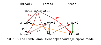

Test Z6.5+po+dmb+dmb
Executions for behaviour: "2:R1=0 ; y=2 ; z=2"
ARM Z6.5+po+dmb+dmb
"PodWW Wse DMBdWW Wse DMBdWR Fre"
Cycle=Fre PodWW Wse DMBdWW Wse DMBdWR
Prefetch=0:x=F,0:y=W,1:y=F,1:z=W,2:z=F,2:x=T
Com=Ws Ws Fr
Orig=PodWW Wse DMBdWW Wse DMBdWR Fre
%x0=x; %y0=y;
%y1=y; %z1=z;
%z2=z; %x2=x;
 P0           | P1           | P2           ;
 MOV R0,#1    | MOV R0,#2    | MOV R0,#2    ;
 STR R0,[%x0] | STR R0,[%y1] | STR R0,[%z2] ;
 MOV R1,#1    | DMB          | DMB          ;
 STR R1,[%y0] | MOV R1,#1    | LDR R1,[%x2] ;
              | STR R1,[%z1] |              ;
Observed
    2:R1=0; y=2; z=2;
