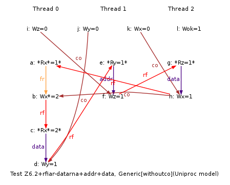

Test Z6.2+rfiar-datarna+addr+data
Executions for behaviour: "0:R0=1 ; 0:R1=2 ; 1:R0=1 ; 2:R0=1 ; ok=1 ; x=2"
ARM Z6.2+rfiar-datarna+addr+data
"RfiAR DpDatadWRNa Rfe DpAddrdW Rfe DpDatadW WseNaA"
Cycle=RfiAR DpDatadWRNa Rfe DpAddrdW Rfe DpDatadW WseNaA
Prefetch=0:x=F,0:y=W,1:y=F,1:z=W,2:z=F,2:x=W
Com=Rf Rf Ws
Orig=RfiAR DpDatadWRNa Rfe DpAddrdW Rfe DpDatadW WseNaA

 P0                  | P1              | P2           ;
 MOV %T3,#2          | LDR R0,[%y1]    | LDR R0,[%z2] ;
 LDREX R0,[%x0]      | EOR R1,R0,R0    | EOR R1,R0,R0 ;
 STREX %T2,%T3,[%x0] | MOV R2,#1       | ADD R1,R1,#1 ;
 CMP %T2,#0          | STR R2,[R1,%z1] | STR R1,[%x2] ;
 BNE Fail0           |                 |              ;
 LDREX R1,[%x0]      |                 |              ;
 EOR R2,R1,R1        |                 |              ;
 ADD R2,R2,#1        |                 |              ;
 STR R2,[%y0]        |                 |              ;
 B Exit0             |                 |              ;
 Fail0:              |                 |              ;
 MOV R3,#0           |                 |              ;
 STR R3,[%ok0]       |                 |              ;
 Exit0:              |                 |              ;
    0:R0=1; 0:R1=2; 1:R0=1; 2:R0=1; ok=1; x=2;
