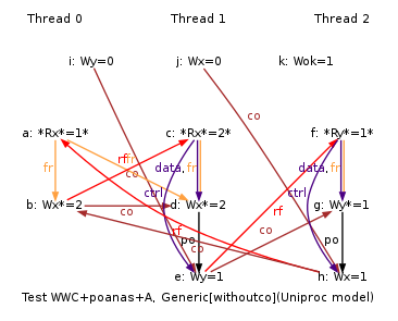

Test WWC+poanas+A
Executions for behaviour: "0:R0=1 ; 1:R0=2 ; 2:R0=1 ; ok=1 ; x=2 ; y=1"
ARM WWC+poanas+A
"RfeAA PodRWANa RfeNaA PodRWANa WseNaA"
Cycle=RfeNaA PodRWANa WseNaA RfeAA PodRWANa
Prefetch=1:x=F,1:y=W,2:y=F,2:x=W
Com=Rf Rf Ws
Orig=RfeAA PodRWANa RfeNaA PodRWANa WseNaA
{ ok=1;
%x0=x; %ok0=ok;
%x1=x; %y1=y; %ok1=ok;
%y2=y; %x2=x; %ok2=ok;
 P0                  | P1                 | P2                 ;
 MOV %T3,#2          | LDREX R0,[%x1]     | LDREX R0,[%y2]     ;
 LDREX R0,[%x0]      | STREX %T2,R0,[%x1] | STREX %T2,R0,[%y2] ;
 STREX %T2,%T3,[%x0] | CMP %T2,#0         | CMP %T2,#0         ;
 CMP %T2,#0          | BNE Fail1          | BNE Fail2          ;
 BNE Fail0           | MOV R1,#1          | MOV R1,#1          ;
 B Exit0             | STR R1,[%y1]       | STR R1,[%x2]       ;
 Fail0:              | B Exit1            | B Exit2            ;
 MOV R1,#0           | Fail1:             | Fail2:             ;
 STR R1,[%ok0]       | MOV R2,#0          | MOV R2,#0          ;
 Exit0:              | STR R2,[%ok1]      | STR R2,[%ok2]      ;
                     | Exit1:             | Exit2:             ;
Observed
    0:R0=1; 1:R0=2; 2:R0=1; ok=1; x=2; y=1;
