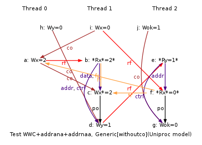

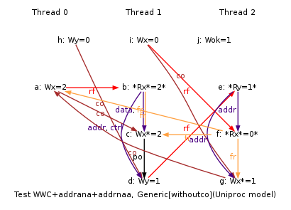

Test WWC+addrana+addrnaa
Executions for behaviour: "1:R0=2 ; 2:R0=1 ; 2:R2=0 ; ok=0 ; x=2"
Executions for behaviour: "1:R0=2 ; 2:R0=1 ; 2:R2=0 ; ok=1 ; x=2"
ARM WWC+addrana+addrnaa
"RfeNaA DpAddrdWANa Rfe DpAddrdWNaA WseANa"
Cycle=Rfe DpAddrdWNaA WseANa RfeNaA DpAddrdWANa
Prefetch=1:x=F,1:y=W,2:y=F,2:x=W
Com=Rf Rf Ws
Orig=RfeNaA DpAddrdWANa Rfe DpAddrdWNaA WseANa

Observed
    1:R0=2; 2:R0=1; 2:R2=0; ok=0; x=2;
and 1:R0=2; 2:R0=1; 2:R2=0; ok=1; x=2;
