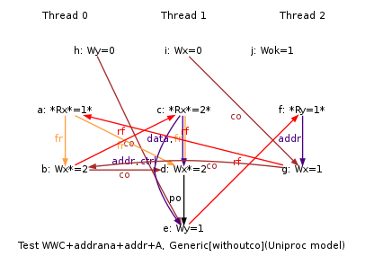

Test WWC+addrana+addr+A
Executions for behaviour: "0:R0=1 ; 1:R0=2 ; 2:R0=1 ; ok=1 ; x=2"
ARM WWC+addrana+addr+A
"RfeAA DpAddrdWANa Rfe DpAddrdW WseNaA"
Cycle=Rfe DpAddrdW WseNaA RfeAA DpAddrdWANa
Prefetch=1:x=F,1:y=W,2:y=F,2:x=W
Com=Rf Rf Ws
Orig=RfeAA DpAddrdWANa Rfe DpAddrdW WseNaA
{ ok=1;
%x0=x; %ok0=ok;
%x1=x; %y1=y; %ok1=ok;
%y2=y; %x2=x;
 P0                  | P1                 | P2              ;
 MOV %T3,#2          | LDREX R0,[%x1]     | LDR R0,[%y2]    ;
 LDREX R0,[%x0]      | STREX %T2,R0,[%x1] | EOR R1,R0,R0    ;
 STREX %T2,%T3,[%x0] | CMP %T2,#0         | MOV R2,#1       ;
 CMP %T2,#0          | BNE Fail1          | STR R2,[R1,%x2] ;
 BNE Fail0           | EOR R1,R0,R0       |                 ;
 B Exit0             | MOV R2,#1          |                 ;
 Fail0:              | STR R2,[R1,%y1]    |                 ;
 MOV R1,#0           | B Exit1            |                 ;
 STR R1,[%ok0]       | Fail1:             |                 ;
 Exit0:              | MOV R3,#0          |                 ;
                     | STR R3,[%ok1]      |                 ;
                     | Exit1:             |                 ;
Observed
    0:R0=1; 1:R0=2; 2:R0=1; ok=1; x=2;
