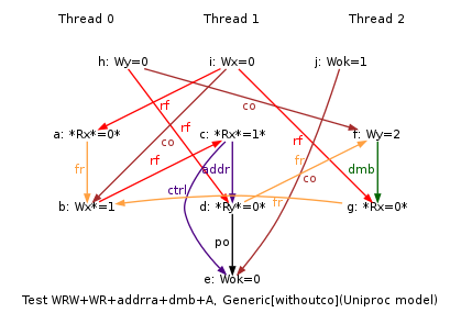

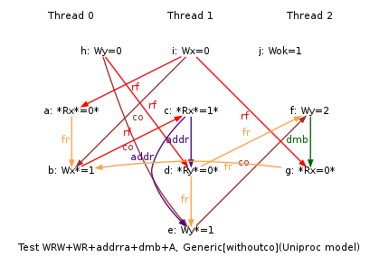

Test WRW+WR+addrra+dmb+A
Executions for behaviour: "0:R0=0 ; 1:R0=1 ; 1:R2=0 ; 2:R1=0 ; ok=0 ; x=1 ; y=2"
Executions for behaviour: "0:R0=0 ; 1:R0=1 ; 1:R2=0 ; 2:R1=0 ; ok=1 ; x=1 ; y=2"
ARM WRW+WR+addrra+dmb+A
"RfeAR DpAddrdWRA WseANa DMBdWR FreNaA"
Cycle=RfeAR DpAddrdWRA WseANa DMBdWR FreNaA
Prefetch=1:x=F,1:y=W,2:y=F,2:x=T
Com=Rf Ws Fr
Orig=RfeAR DpAddrdWRA WseANa DMBdWR FreNaA
{ ok=1;
%x0=x; %ok0=ok;
%x1=x; %y1=y; %ok1=ok;
%y2=y; %x2=x;
 P0                  | P1                  | P2           ;
 MOV %T3,#1          | LDREX R0,[%x1]      | MOV R0,#2    ;
 LDREX R0,[%x0]      | EOR R1,R0,R0        | STR R0,[%y2] ;
 STREX %T2,%T3,[%x0] | ADD %T1,R1,%y1      | DMB          ;
 CMP %T2,#0          | MOV %T3,#1          | LDR R1,[%x2] ;
 BNE Fail0           | LDREX R2,[%T1]      |              ;
 B Exit0             | STREX %T2,%T3,[%T1] |              ;
 Fail0:              | CMP %T2,#0          |              ;
 MOV R1,#0           | BNE Fail1           |              ;
 STR R1,[%ok0]       | B Exit1             |              ;
 Exit0:              | Fail1:              |              ;
                     | MOV R3,#0           |              ;
                     | STR R3,[%ok1]       |              ;
                     | Exit1:              |              ;
Observed
    0:R0=0; 1:R0=1; 1:R2=0; 2:R1=0; ok=0; x=1; y=2;
and 0:R0=0; 1:R0=1; 1:R2=0; 2:R1=0; ok=1; x=1; y=2;
